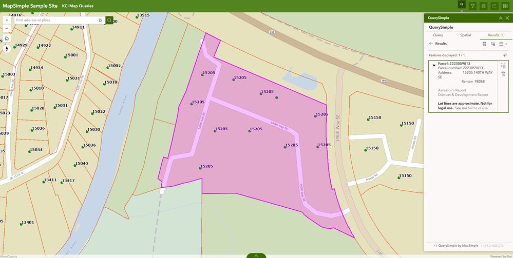

When you open the demo, look at the layer list. The magnifying glass icon is a persistent result layer controlled by the layer list, like any other operational layer. The funnel icon is a widget-managed graphics layer that appears and disappears based on the widget's state. Both are live in the demo, so you can see the difference in action.

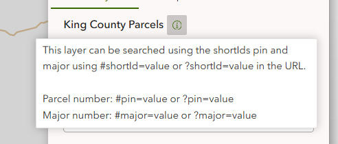

  • Auto-generated info button per layer: when a ShortId is configured, a help icon automatically appears next to the layer title, showing users the exact URL format for both hash and query string deep links

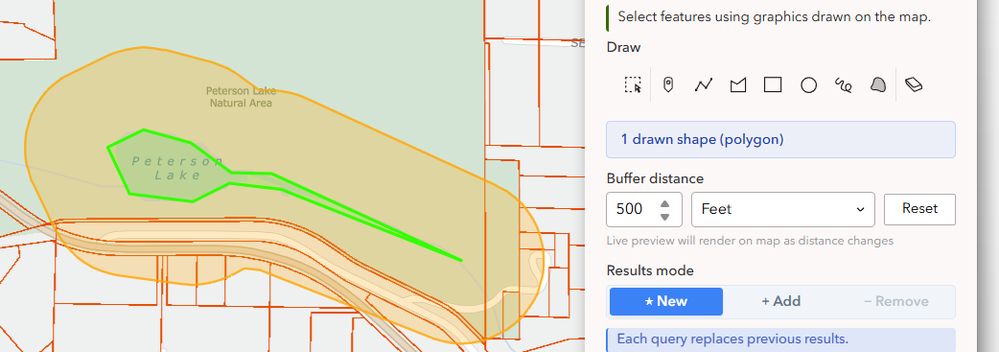

  • Operations mode: use results as source with real-time geodesic buffer preview on the map as distance changes
  • Draw mode: 7 tools, including freehand line and polygon, geometries accumulate

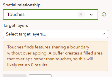

  • 7 spatial relationships with context-aware warnings: when a selected relationship combined with the current geometry or buffer is likely to return zero results, an amber warning explains why before execution

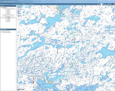

I was recently asked to investigate options that reproduce the functionality of the query tool from ArcIMS (yes, ArcIMS!) in an updated ExB app. The specific functionality my users wish to see is features flash or highlight when mousing over the results in the returned results table. Your QuerySimple widget is very similar with its hover preview pin. This is great but, in addition to that, I would like to see the feature also highlight and differentiate from the surrounding features.
Is this functionality you have considered adding to a future release or something a non-developer like myself could do to extend the widget?

The choice between the two would be cool with both being more advantageous than the other in particular use cases. In my use case, transmission lines with multiple sections (spans between angle towers), some that are very long and others that are very short relative to the total line length, highlighting the linear feature on hover seems the best option and would definitely help distinguish the section from the rest of the line.
