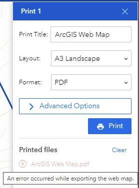

AndyWells
No, we do not have a print server (wish we did.) We are just trying to use the ArcGIS Online print service. I had that tried that same URL, and I have just now tried copying the one out of your reply, just in case I did it wrong, but it is still not working. The widget seems to find the list of Layouts and Formats ok, so it seems like it is at least finding the AGO print service, but it keeps giving me the error "An error occurred while exporting the web map."

@AndyWells
Does your webmap contain any secured layers? Have you tried with a different webmap in your app?

@AndyWells  OK it seems that you might have missed one of the most basic steps of setting up widgets that deal with a map. That is to set the map that the widget will interact with in the setting of the widget after you have added it to your app. In the right panel of EB once you click on the print widget you will see where you can specify the map widget that the print widget will use. This is something you need to get use to as EB can have one or more maps in an app.
AndyWells
@RobertScheitlin__GISP
Yes! That was it. Thank you for setting me straight. I'm new with using Experience Builder and have to get used to the fact that there can be multiple, or no, maps. I really appreciate you helping me out. Thanks.

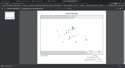

DavidColey
MVP Frequent Contributor

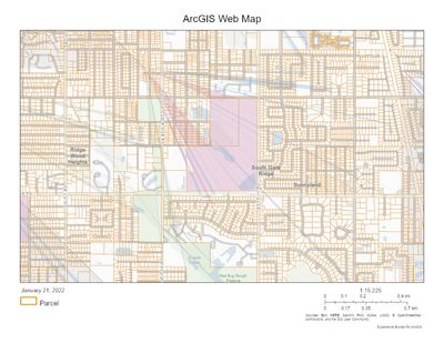

Thanks @RobertScheitlin__GISP . After testing, I would agree this is likely a print service issue that began some time ago with certain basemaps in the WAB.
The default print services are continuing to not handle the vector tile basemaps with any consistency.
I initially used the default service in your config from sample server 6, changed it again to the default arcgisonline utility print service, and finally my own federated servers' print service at 10.9.1.  All produced not-good-results; some better, some worse depending on the basemap . . .
These samples are about the best I can get with my own print service and my own vector tile basemap:

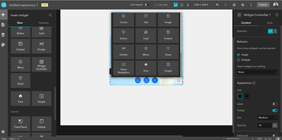

JorgeKappa
I followed the recipe to the letter, the Print widget shows, but it won't add. What could be wrong?
MVP Emeritus
@JorgeKappa
The patch is for 1.6 only you are at 1.7 so it is unnecessary. Could be causing you an issue. I would start with a clean 1.7 install and try again. Also just to be sure we are not miscommunicating. The browsers web console is different then the Command window that you are showing in your attachments above. Once you do your clean install and try and add the print widget check your browsers web console for any errors.
JorgeKappa

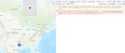

Got it. Now it adds, but I'm getting this:
MVP Emeritus
perfect so the fact that you now see the widget placeholder (the little printer icon), that tells me that you have not set the widgets map that it will using in the widgets settings pane.
JorgeKappa
Works tip top! Thank you Robert. I can't kudos or mark as solution, it's grayed out.

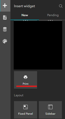

ZhujingXia
I am ne to EB, this is my first time to add the custom widget into EB 1.7 developer edition. I followed your instruction, copy past the extracted print folder to EB\client\your-extensions\widgets. After that i did the steps for  nmp like i normally do to start my EB.
But the print widget is not avaliable in EB.  Could you help?
Thanks
Zhuijng
MVP Emeritus
@ZhujingXia  Strange. What version of EB developer are you using? I have tested up to 1.8. Also you have to have be attempting to add the widget to a controller in EB and then the print widget will appear in the custom section of widgets (in 1.8)

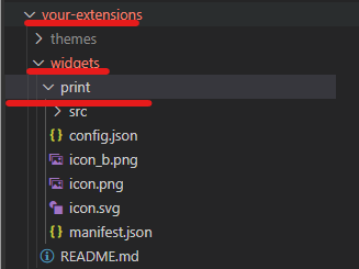

Ming
Hi @ZhujingXia
With VS Code, please make sure the print folder is under folder "your-extensions/widgets", then with EX Builder make sure it opens the project that has the print folder, in case you have more than one EX projects.
FYI:
ZhujingXia
Thank you all, I installed the new version of node.js , it worked after that.

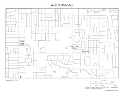

Here is my experience about label print, hope it can help who has same problem.
If the layer label is generated on fly like this:
$feature["label_no"] + " - " + $feature["facility_name_location"]
Then by default this print widget can't print the label out in pdf. Solution is to set forceFeatureAttributes of print templae as true then it works well, like this:

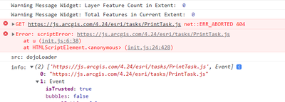

@RobertScheitlin__GISP testing this on the new 1.9 Dev edition and it does not work anymore for me. I am getting error on the PrintTask, but its not deprecated so not sure whats going on. Also watchUtils are now deprecated, but should work.
Edit: I know the new Print widget came out but it has a bug for me where the "customTextElement" is not displayed properly, it displays it in one long line, overruling the print template where its word wrapped, configuration while this custom print widget works perfectly...
Edit 2: ok, i've just read the release blog and support for esri/tasks has been removed since JS 4.24 so that makes sense... https://www.esri.com/arcgis-blog/products/js-api-arcgis/developers/rest-is-up-to-the-task/

@SerjStol my print widget has not been updated to WAB 1.9 yet.
