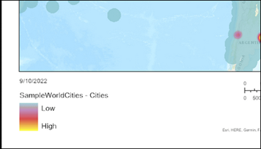

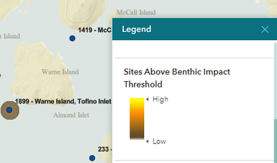

Hi @RobertScheitlin__GISP , just found that the Print widget can't print out the title of the heat map legend. For example, the Legend displays like this:
After print out, like this:
So are there any suggestions and tips?
Thanks!

@Ming Sorry to say that that has nothing to do with the widget and everything to do with how the print service on ArcGIS server handles the heatmap layer type.

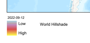

It should work from print service side. Please see this screenshot when I tried AGOL's default print service.
What version of arcgis server you have? Is that a print service your published with your own layouts? If so, can you pls share your .pagx file?

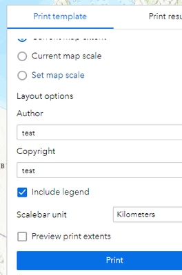

2. Open map in Map Viewer, then use the print button and check Include legend option:

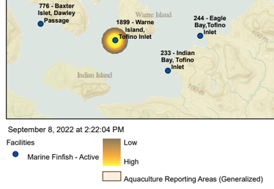

3. The exported file has no heat map legend title:

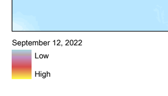

6. The print result has no heat map legend title:
If you have any suggestion, please let me know, thank you very much!

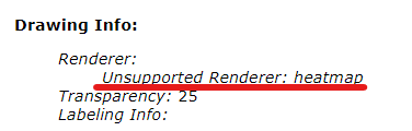

For our feature layer, the classic map viewer can print out the heat map legend title, but the map viewer still CAN'T.
https://msdidfo12.esriservices.ca/arcgis/rest/services/Hosted/CAPRI_Joined_ENGLISH_int/FeatureServer...
It is hosed on ArcGIS Server 10.81, and noticed that the Drawing Info says "Unsupported Render: heatmap".
Any idea and suggestion?
That sounds like an issue with hosted feature service. Would you call Esri support or submit a question in AGOL/Hosted FS queue?

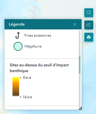

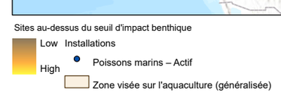

Then found another issue that is for French version, the Low/High in printed legend is not translated into French:
Although the heat map legend in the map has been translated to French by changing the map owner's profile and set its default language to French:

Update - here is another related bug confirmed:
BUG-000152950: When printing a web map with a legend using heat map symbology in Map Viewer, the language of the legend is English even when the owner's language preference is set to French.
