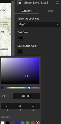

I wanted to allow the user to change the colors of the save and clear buttons but I hit a snag. While the colors do change, the slider icon and details on the jimu-ui ColorPicker component doesnt update. The color and details in the setting pane just stay the same. Has anyone ever experienced that behavior before? How do I get those details to update?

I had the same issues. I believe the problem is with different format how the color is saved in config and the format which the component ColorPicker is using.
<ColorPicker
                      color={props.config.graphicsColor}
                      width={30}
                      height={30}
                      showArrow={true}
                      placement={'bottom'}
                      disableAlpha={false}
                      onChange={(value) => { onMapGraphicsColorChanged(value); }} />
const onMapGraphicsColorChanged = (value: string): void => {
    // color in array format needs to be transformed to rgba(255,255,255, 1) format which is readable by ColorPicker component
    const rgbaString = rgbaToRgbaString(value);
    props.onSettingChange({
      config: {
        ...props.config,
        graphicsColor: rgbaString
Initial value in config.json
  "graphicsColor": "rgba(0, 255, 255, 0.65)",
