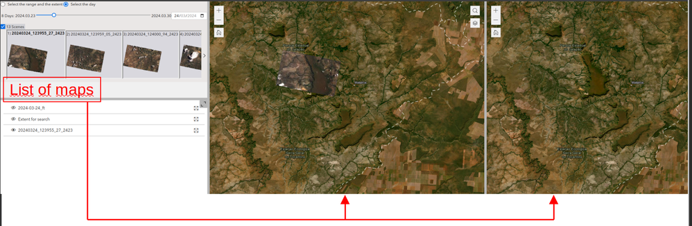

I would like to provide a list of maps for the user to choose the map where the layer will be added.
1) In the setting/setting.tsx file we provide the selection the map to work with custom widget, then, all layers are added in this map.
2) I'd like you to be able to choose which map the image (satellite) is placed on in the custom widget.
At the moment, only ONE map can be used.
* The satellite image is added when you click on the picture (Thumbnails)

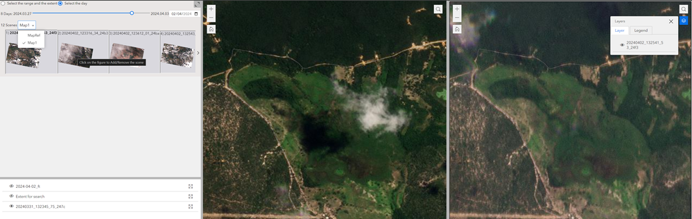

The answer is: Yes, we can select the MapWidget (map).
The figure shows two maps and there is a Select Widget (custom widget), in which we can select the map (MapRef or Map1) to add the desired images (cliking in the satellite picture inside ScrollList).
How?
The class (API) that allows you to manage MapWidgets is MapViewManager ('jimu-arcgis').
The instance of this class can be obtained by "MapViewManager.getInstance()", I preferred to obtain the instance by accessing one of the MapView [1].

lmotta_ibama
Thanks @JeffreyThompson2 ,
The Swipe Widget tool would be great, but this tool uses a previously defined data source (setting).
The my customized widget, the user can add and remove layers (WebTileLayer), which means that my data is dynamic and not fixed (necessary for the Swipe tool).
One solution is to make it so that we can select the MapView we want to add the layers to.
I discovered the MapViewManager class (jimu-arcgis), which allows you to identify MapViews. I think I'll be able to solve the problem.

lmotta_ibama
This widget by JS API would solve the problem of comparing layers (images).
Conceptually, the widget I'm developing is for using the Planet's daily images (choose and add/remove), so its scope is defined.
Another custom widget using the JS API with Swipe would be wonderful.
Thanks again
