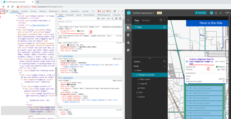

@LondonWalker ,
In your browser utilize the developer tools (F12) to identify which class is assigned the gray color.  You will then need to override that class in your widget CSS.  You can also temporarily override the color in your browser to experiment with the desired effect.  Do note, overriding ESRI CSS may impact other experience builder components.  You can add an additional class to your widget to apply this exclusively.  You may need to utilize the CSS !important Property to force your CSS preference.
For example in the image below, I have temporarily set the backgound-color for .jimu-widget.esri-layer-list.esri-widget.esri-widget--panel to green.

@LondonWalker ,
