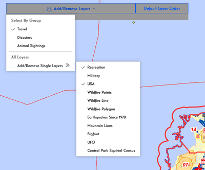

If your user has loaded their layers with the layer groups and they use the drag-and-drop reordering in the Map Layers Widget, the Default Layer Order button will instantly restore the order designated by your groups.
How to use:
Open /src/components/layers.ts and replace the dummy data with the layers and groups you want to use. I recommend setting your Map Widget to a WebMap with only a basemap and no layer data and loading all of your data from this widget. By default, groups[0] will appear selected on load, you may wish to set this to null or a different group. If you chose to have a group selected on load, each layer in that group should be set to activeOnLoad: true. Every layer must be designated as a FeatureLayer or a MapImageLayer by using the layerType property and setting it to layerType.feature or layerType.mapImage. In the Settings Panel, use the dropdown menu to connect this widget to a Map Widget.
If you are loading all of your operational layers from this widget or you want your layers added below any WebMap layers, set the Start Adding Layers At Index value to 0. Higher numbers will cause your layers to paint on top of any WebMap layers with a lower index. Out of range values could cause unexpected results. Set the Reordering Delay to slightly longer than you expect your most complicated group change (largest amount of layers and/or data being added/removed at once) to take. The Default Layer Order button can be switched off if you do not want to show this option to your users.

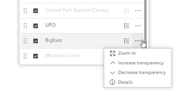

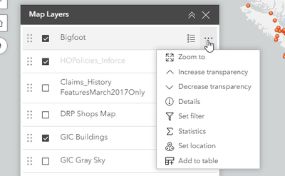

Also here is a bit of feedback. I grabbed your widget to give it a try and see an issue that I recently found with a custom widget I built. It seems like re-ordering the layers breaks the extended functionality gained by utilizing the data manager. If I add the bigfoot layer individually, it stays at the top and the options to add to table, set filter, etc are available. However, when that layer is added through the Animal Sightings group, the re-order happens and the layer context menu gets stripped down to the 4 basic options. I work with Jwilner_Amica so we are going to try to figure that issue out next.
Update: I confirmed the same behavior with the Add Data Widget. Possible bug with the Layer List Widget.

@BrianLeroux https://community.esri.com/t5/arcgis-experience-builder-questions/loss-of-runtime-created-datasource...
I tested the Add Data Widget in ArcGIS Online and found it also loses the data actions in the Map Layer Widget after re-ordering. The Online version should be the same as 1.15. So, it appears that this widget is currently only compatible with Experience Builder 1.14. If you want to use this widget in 1.15, comment out all the calls to the defaultOrder() function. Data functions should be available, but layers may load out of order.
