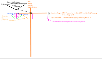

The lines need an attachment point or line end(in case of a dead end) to attach to the pole.  We suggest containing the insulators as content of the attachment point.  There could be 1-3 insulators per conductor and with 1-N conductors represented by a single line in GIS, there is no easy way to map the insulators as features.
The other challenge when trying to map GIS features to 3D is the location of the lines related to the tower.  As there are 1:N conductors in reality, but 1 line in GIS, how do you accurately show the N conductors?
What we are discussing is a process that will use the attribute info of the attachment point and details of the content that will generate the 3D representation of the features at that location.
This is just a rough idea of the result.  The info to create this is stored on the attachment point and in the JO records.

To answer your question about Linear Insulators, we have discussed this and even played around with modeling these in the Electric Line class.  You will need to add a junction to the conductor to allow you to connect to the insulator, then add Jumpers to connect the conductors around the insulators.  The insulator needs to terminate at an attachment point, which will be attached to the to tower.
You can definitely extend the model to include these assets.
