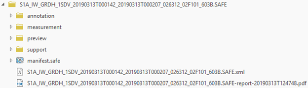

The European Space Agency (ESA) distributes Sentinel products in SAFE (Standard Archive Format for Europe) format. ESA provides its products in a ZIP archive that includes a folder with the .SAFE suffix appended to the name. Imagery and product metadata are stored inside the folder. When you work with Sentinel products in ArcGIS Pro, the manifest.safe file is used as a raster product.
The “manifest.safe” file acts as an entry point for the imagery and metadata, allowing ArcGIS Pro to interpret the dataset correctly. Credit: Copernicus Sentinel data 2019.The “manifest.safe” file acts as an entry point for the imagery and metadata, allowing ArcGIS Pro to interpret the dataset correctly. Credit: Copernicus Sentinel data 2019.
