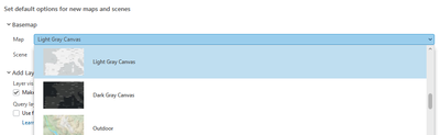

Default Basemaps
Also found in the Map and Scene tab of the Options dialog box, choose a default basemap. The default is to use the default of your organization, but if there is a basemap that you are consistently using (I, personally, am drawn to Light Gray Canvas), set that as your default basemap and let the mapping begin!
This will set the default basemap for every new map created in ArcGIS Pro.
Set the default basemap for new mapsSet the default basemap for new maps

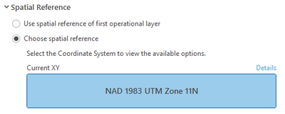

Default Coordinate Systems
To ensure maps are using the correct coordinate system, customize the default coordinate system settings. In the Options dialog box, navigate to the Map and Scene tab, then expand Spatial Reference.
By default in ArcGIS Pro, maps will take the spatial reference of the first operational layer. Any additional data will be projected on-the-fly to match the coordinate system of the first operational layer. Instead, customize ArcGIS Pro to use a default spatial reference for maps. This is great if your organization has a standard spatial reference.
For example, say my organization uses NAD 1983 UTM Zone 11N for their standard coordinate system. I can set the default spatial reference. Then, when I add data to a new map, regardless of the coordinate system of the first operational layer, my map will be set to NAD 1983 UTM Zone 11N and data will be projected on-the-fly to match my organization’s standard.
Set the default spatial reference for mapsSet the default spatial reference for maps

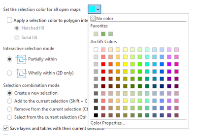

Selection Colors
By default, selected features are indicated with a neon cyan outline color. This can sometimes be a difficult color to view, depending on how data is symbolized. In the Selection tab, set the selection color to any color.
Set the selection color for all open mapsSet the selection color for all open maps

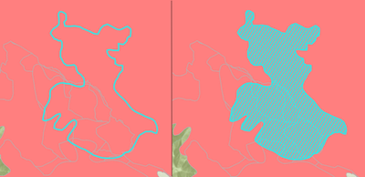

Another option within this section is to check the box to apply either a hatched or solid fill color to selected features. This can be especially helpful when working with lots of overlapping polygons.
On the left, selection with no fill. On the right, selection with hatched fillOn the left, selection with no fill. On the right, selection with hatched fill

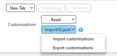

To share with others, export customizations as a .proExportedUI file. In Options, in Customize the Ribbon, click on the Import/Export button, then export to export customizations (this includes Pane Sets, Custom Tabs, Quick Access Toolbar, and Keyboard shortcuts) as a .proExportedUI file. Then someone else can import the customization file. This sharing of customization files is a great option to standardize workflows in an organization. This is a great way to get everyone on the same page and working faster.
Import and export a .proExportedUI file to share customization options with othersImport and export a .proExportedUI file to share customization options with others
