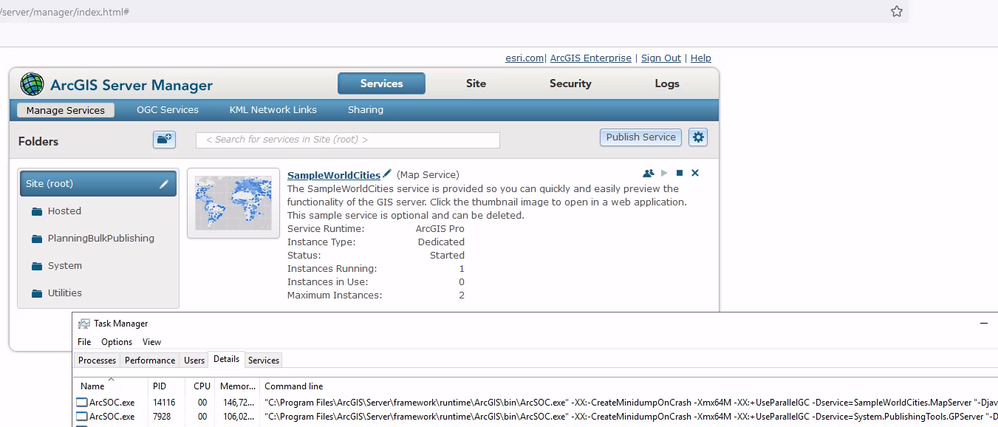

Another result of starting a service in ArcGIS Server is that the manager components of our “office” will start the minimum number of instances set for the service, by default this is one instance. Technically an instance of a service is a single processing unit, typically manifested as an ArcSOC.exe process running in the operating system of the host computer. You can think of an instance of a service as an analyst sitting at a desk with the required ArcGIS Pro project available to them that can respond to requests for defined capabilities of the advertised GIS resource. Notice the number of instances running is not directly related to the number of applications nor people “using” the service. In this case the instance is running and just waiting for a request. This is called the idle state of the instance.
ArcGIS Server Manager and Windows Task Manager showing instances of a GIS web service.ArcGIS Server Manager and Windows Task Manager showing instances of a GIS web service.

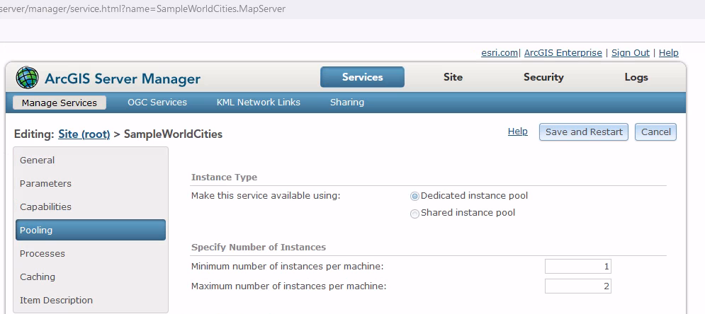

The minimum number of instances defines how many instances of the service are started when the service is started. This can be set to any number including zero. But don’t go crazy with this number, remember the GIS server has finite resources available to it and there are most likely other services running that need to use those resources to support their instances too. But that’s just the minimum. There is also a maximum number of instances that can be instantiated too. This maximum can be greater than or equal to the minimum number of instances. By default, this number is two. So, by default when a service is published to ArcGIS Server the greatest number of virtual analysts that can ever exist to respond to requests to that service is two. Is that going to be enough? Most likely not. Especially if this is a medium to high demand service. But again, remember that although you can set this maximum to any number, you can easily overwhelm your system by allowing more instances to be created than the total system can handle. Also, there will be other services running in ArcGIS Server with their own instances that need to consume those finite resources too.
ArcGIS Server Manager with instance configuration settings.ArcGIS Server Manager with instance configuration settings.
Up until ArcGIS 10.7, this was the only way to control the number of analysts (instances) that existed in our GIS office (ArcGIS Server). All the instances that existed in ArcGIS Server were defined for each service separately and were only able to respond to requests for that service. We can think of this as if each analyst in our GIS office can only open one project at a time in ArcGIS Pro and the project can only have one map, or scene, or model, or other single GIS resource in it that the analyst can interact with to respond to requests. These are referred to as dedicated instances.

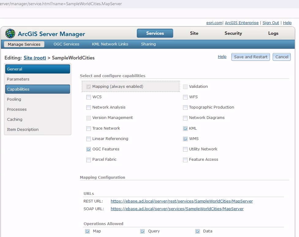

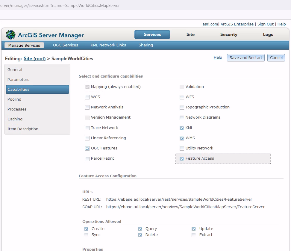

One last consideration when talking about instances of a service is that not all the services our users have access to are managed as separate services in ArcGIS Server. For example, when you publish a map service there is a map service made available in Server Manager for managing properties like the min/max number of instances. That map service also has its own URL, or end point, that clients communicate through. But the map service object in ArcGIS Server Manager also has a capabilities property. Through this property additional capabilities can be enabled like the feature access capability. Enabling this will cause ArcGIS Server to create another URL for a feature service. But this feature service, and any other services enabled via a capability, does not instantiate its own instances. The original instances created for the associated map service also support the feature service.
ArcGIS Server Manager showing the URL of a map service.ArcGIS Server Manager showing the URL of a map service.
ArcGIS Server Manager showing the URL of a feature service.ArcGIS Server Manager showing the URL of a feature service.
