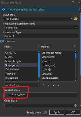

JohannesLindner
MVP Alum
Just the part after the equals sign.

Use the field calculator.  Assuming you have added a field of the appropriate type
python parser
!YourOtherField!
note the ! marks surrounding your other fields name

I have tried like this:
!NewField!=!MyField!
Is that correct?
Cause I got error in terms on Null values!?
