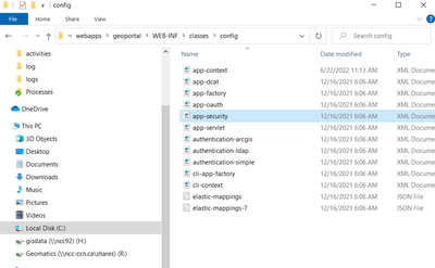

From your log, it looks like your security configuration is invalid. Can you validate app-security.xml? Also check in your geoportal configuration file to make sure it points to the collect app-security.xml.

Its not about windows 8.1, actually its unstable in different versions of windows 10 also. We can't insist the client to have correct version of window's 10 in their server right? in my opinion the error starts with "Failed to read schema document 'http://www.springframework.org/schema/security/spring-security-oauth2-2.0.xsd"(which is  in app.oauth.xml in the screenshot you given). I'm completely clueless what to do to rectify this. Do you have any suggestion? Do I need to change any java dependency or java version ? can you specify your java version and tomcat version you are using ?
