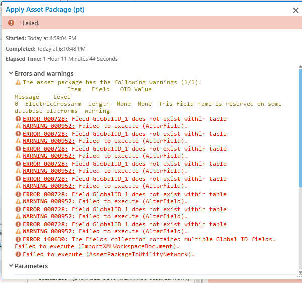

Hi All,
Is there any solution to remove the below error during the process of updating the asset package to FGDB.
SrinivasaRao1
Please let us know how we can fix this issue, if the feature can be deleted is the issue resolved
