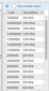

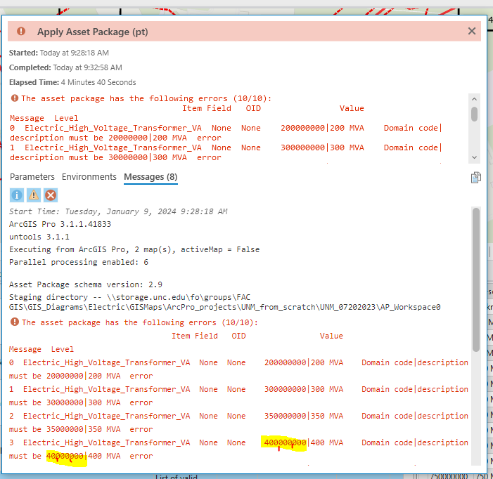

I encountered an error while attempting to use the apply asset package tool. The issue was, apparently, that an extra digit needs to be removed in the domain codes for Electric_High_Voltage_Transformer_VA. This comes from the Electric Utility Network Foundation. There are actually repeat Description values with different coded values. It looks like I will need to edit this domain in the foundation. Are there any more issues like this in the Electric Utility Network Foundation?

I went ahead and deleted the offending extra entries in the domain Electric_High_Voltage_Transformer_VA and ran the Apply Asset Package tool again. This time it completed successfully after 5 hrs 25mins.

I don't think that answer is responsive. The domain network, which came from the electric utility network foundation, caused an error when the apply asset package tool was run. This was because of repeat description values with different codes in the domain Electric_High_Voltage_Transformer_VA.

If this is an execution of apply asset package with no data, then we will need to know what version of Pro and Enterprise you are using.  Also, can you provide this asset package to me?

It does have data. I am using Arcpro 3.1.1. I am working in a file GDB. I could provide the asset package to you but this domain comes from the electric foundation and that is what caused the error. I don't even have any high voltage transformers in my data.

I just checked in the solutions site and the domain Electric_High_Voltage_Transformer_VA does not appear to have any duplicates in the released model.  Is it possible someone else modified our Asset Package.  If not, can you tell me where you got this Asset Package, I would like to track down where this duplicate got introduced.

I also had this same problem - just deployed the Electric Utility Network Foundation solution and downloaded it. Both the asset package and utility network included have duplicate conflicting entries in Electric_High_Voltage_Transformer_VA domain table
