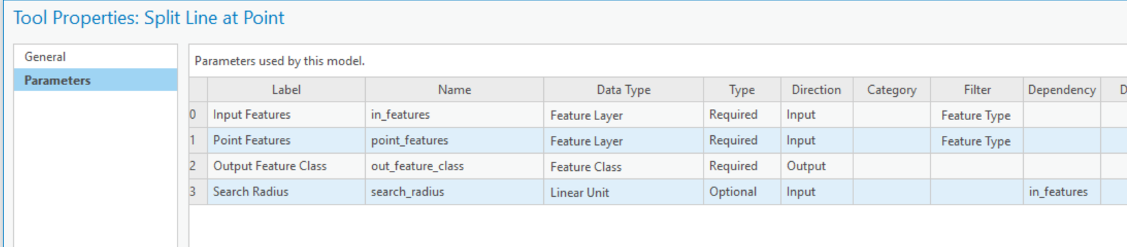

To answer my own question.
Right clikking the tool of interest in ArcGIS Pro and selecting properties.
eg. "Split Line at Point" show:
In this example the name to use is: "toolboxsalias.SplitLineAtPoint".  I still don't know where to find toolboxalias" but i think that this can be figured out by a qualified guess.
The Parameters Show a table of parameters and their Data Type to pack into the valueArray.
Hope this can help someone else.

René_AstadDupont
