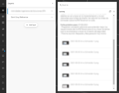

If the pop-up needs to show multiple attachments, the (New) Map viewer is able to do this. If you have multiple picture attachments they will show up in the pop-up:

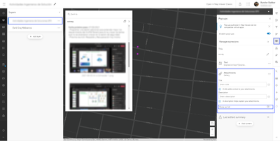

You can enter the settings and switch off the list option to preview the pictures a bit bigger:
