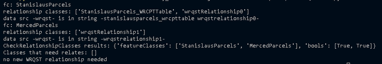

Here is the output, looks good to me.

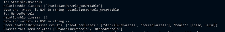

However, if I uncomment those lines to update the table, this is what I get:
It seems to me that overwriting the table using ExcelToTable breaks the relationship class, so I guess the real question is, can I somehow populate the related table with all new entries in such a way that preserves the relationship class?  Or will I need to recreate every relationship class every time the table is updated?
