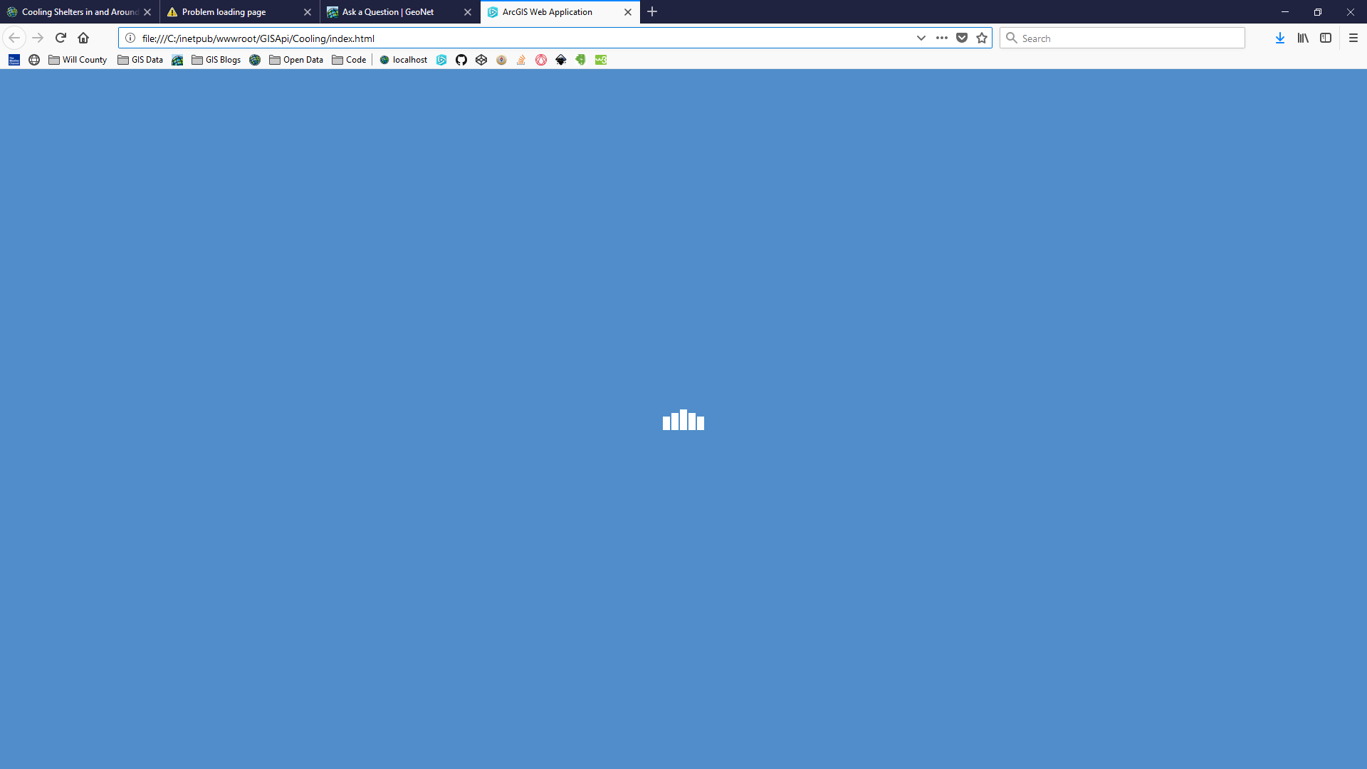

6. I then tried running the app a few ways:
      a. I double clicked the index.html file, but the page never loaded:

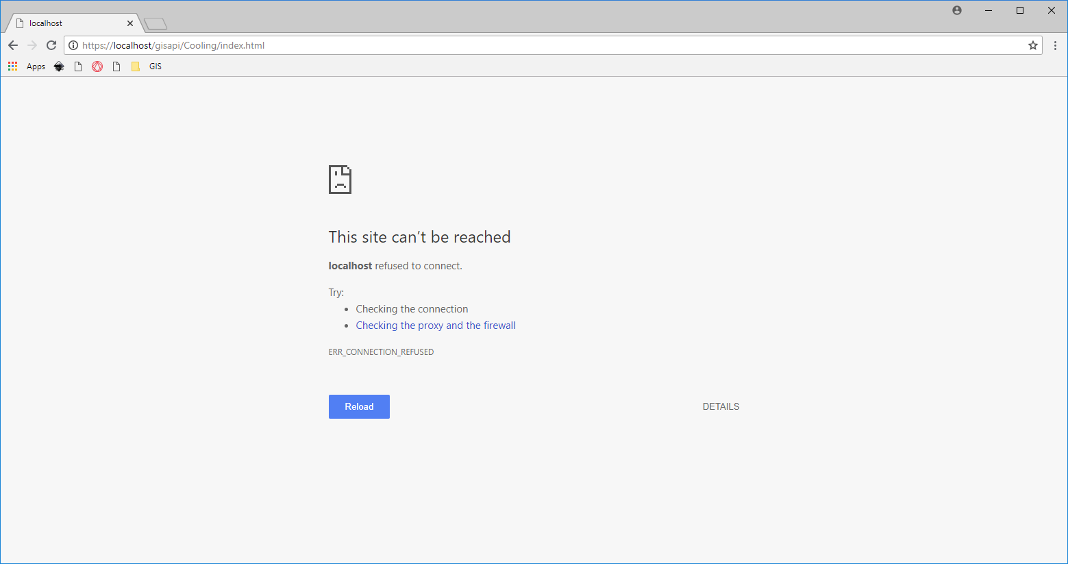

      b. I put these URLs in the browser (Chrome) https://localhost/gisapi/Cooling/index.html
            http://www.willcogis.org/website2014/gis/Cooling
            Here's what happened:
There's no need for a proxy because the app's shared publicly.

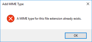

Most likely the issue is that your IIS is not configured to serve JSON files. Typically this is most easily solved by adding a MIME type for the "json" file type using IIS Manager:
Open IIS Manager -> Mime types -> Add a new mime type with
Extension: .json
MIME Type: application/json
JaredPilbeam2
MVP Alum
Gavin,
It's already there.

https://www.screencast.com/t/yETGFfbIBQ5
I followed this video and set up a self-signed certificate for my local server. Then I created a https site bindings in the IIS Manager, whereas before it the url to the app was http.
It works now, but it's painfully slow and the side panel, top panel, widgets are missing. Only the basemap, points and popups are drawing. https://localhost/gisapi/Cooling/
