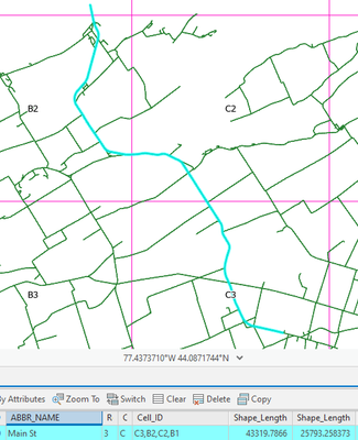

I have created a Cell_ID field to store grid index values in a road feature class. For example, if Main St. falls within grid cells B1, B2, C2 & C3, my Cell_ID field is populated with "C3,B2,C2,B1". Is there any way for me to reorder the values alphabetically and then numerically as B1, B2, C2 & C3?
Solved my problem below:
var arrName = split($feature.Cell_ID, ",")
return concatenate(sort(arrName))
