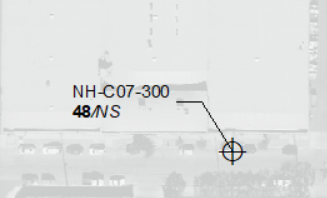

Rajeshmadhaiyan
Hello Josh Carlson,
I have checked the below code it's working good.
It's code come output like. but missing for "/".
 2345

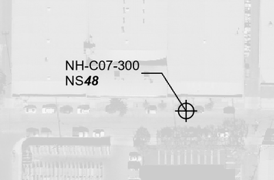

I need to come to below output.
var result
