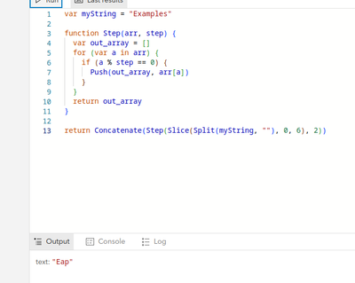

If you throw that loop into a function, it's technically a one-liner when you actually execute it? Not great, though.
var myString = "Examples"
function Step(arr, step) {
  var out_array = []
  for (var a in arr) {
    if (a % step == 0) {
      Push(out_array, arr[a])
  return out_array
return Concatenate(Step(Slice(Split(myString, ""), 0, 6), 2))
