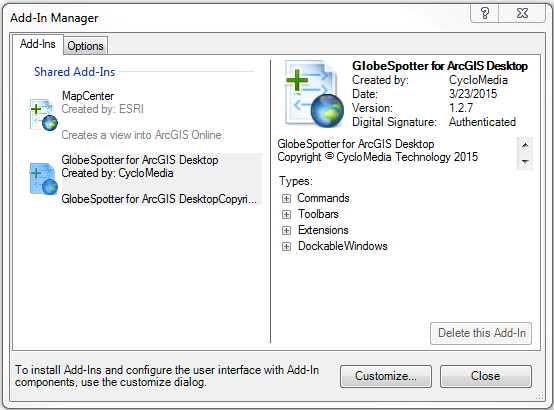

In ArcMap 10.0, 10.1 and 10.2, The Add-In manager show that the Digital Signature is Authenticated, see next picture:

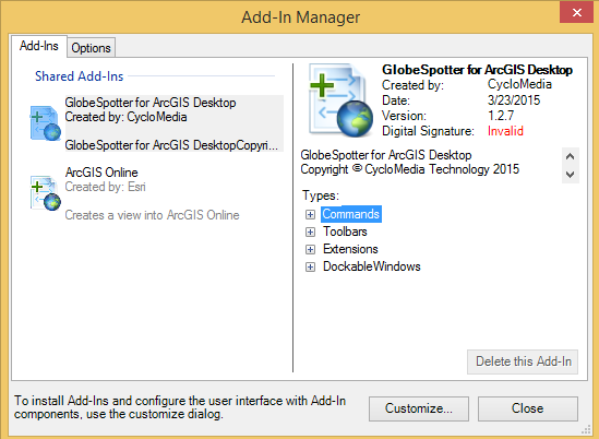

If I open the Add-In Manager in ArcMap 10.3, the same signed Add-in is invalid but that is not true.
What is here the problem?  (see next picture)
ÉricGosselin
This is a Known limit at 10.3:
Reason and workaround:
Checking or analysis of add-ins has gotten better at 10.3. Please resign the Add-in, or ask the Add-in owner/creator to resign.
Link of the bug:
BUG-000084721
BUG-000084721 - Add-ins with digital signatures created in ArcObje..
