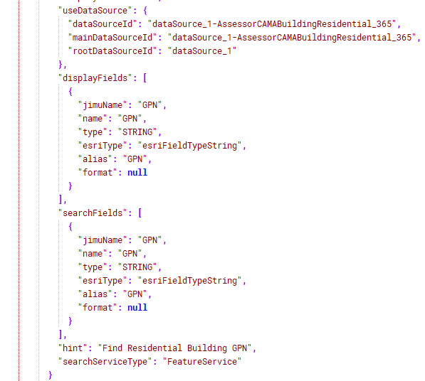

In our case, we have a search widget configured to read from a feature layer.  If I perform a search on this widget, I get a URL similar to the one below.
/?data_id=dataSource_1-AssessorCAMABuildingResidential_365%3A25659
If I poke around in the app config once downloaded, I can find the widget properties, shown below.  So, the "data_id" property in the URL is pointing to however ExB defines the layer source.  You can see in the properties below, we have the search widget configured to search the "GPN" field.
I'm wondering if there's a way to pass in a particular GPN value into the URL...?
