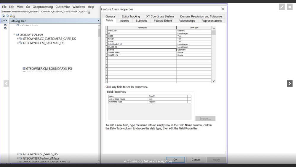

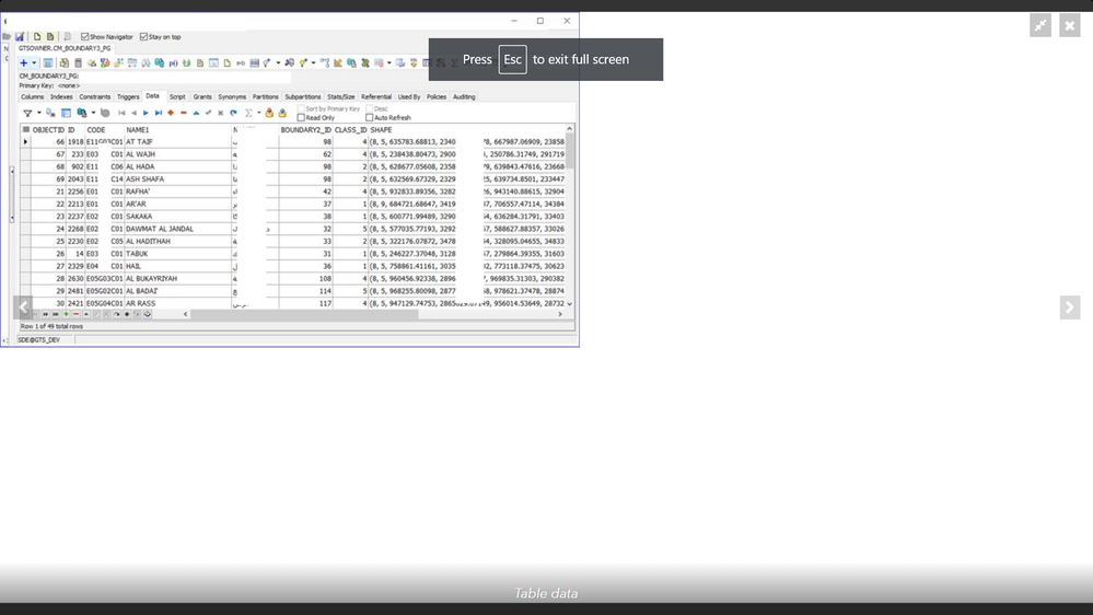

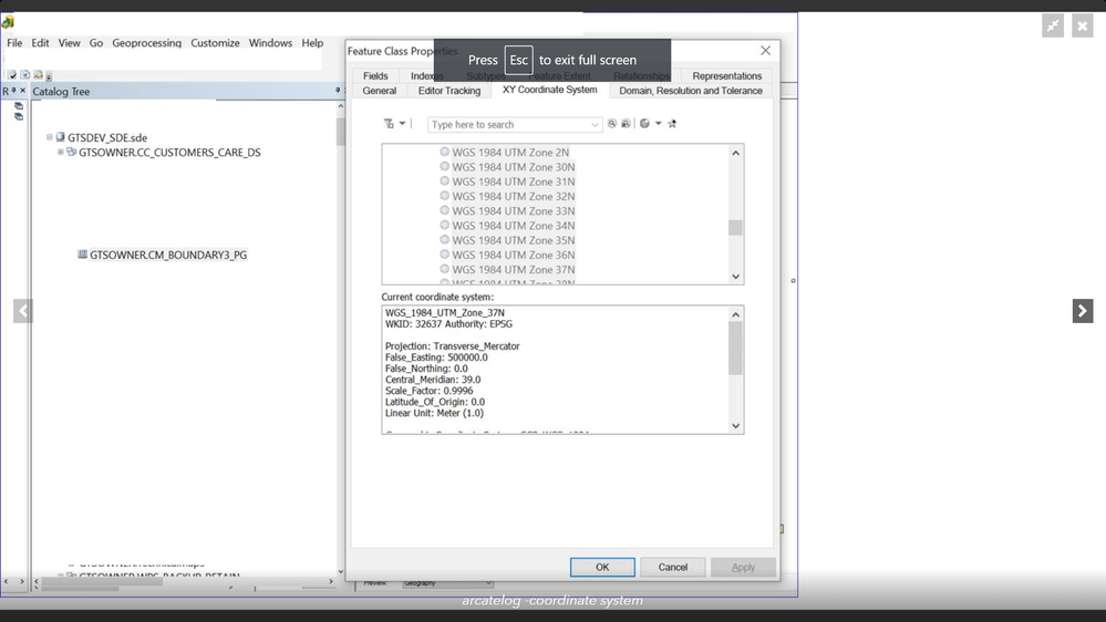

We have a featureclass containing city names and it’s border as polygon shape.The column is st_geometry. We are trying to fetch the city based on the coordinates using the below st geometry query. Even though the coordinates are exactly with in the border the query is not fetching any records.
select NAME1 from GTSOWNER.CM_BOUNDARY3_PG  where sde.st_within (sde.st_point(45.576579,26.460792,32637),shape)=1;
Tried with multiple options without any luck
The database is oracle. the arcGIs version is 10.2
Adeeb
Data type from ArcCatelogData type from ArcCatelogSpatial ReferenceSpatial ReferenceSample Data in TableSample Data in Table
