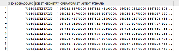

I have an oracle database (11g R2) which each register is a piece of one street. For instance:
SELECT ID_LOGRADOURO, SDE.ST_GEOMETRY_OPERATORS.ST_ASTEXT_F(SHAPE)
FROM GRF_TRECHO_LIN_24
ORDER BY ID_LOGRADOURO;
Where ID_LOGRADOURO identifies uniquely an street.

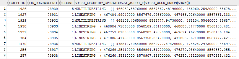

I'm trying to select a union of all pieces of the same streets in one geometry:
SELECT MAX(OBJECTID) OBJECTID, ID_LOGRADOURO, COUNT(OBJECTID) COUNT, SDE.ST_GEOMETRY_OPERATORS.ST_ASTEXT_F(SDE.ST_AGGR_UNION(SHAPE))
GROUP BY ID_LOGRADOURO
Realise that the aggregate function returns a multilinestring if the stree if composed by more than one piece.
I'm looking for a way to get a linestring regardless the street has one or more pieces. How can I do that?
