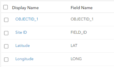

That code is working properly with a dataset I test it with. What are the results that you're getting? And do you have aliases set up properly for your fields?
var fieldsToInclude = ["FIELD_ID",
                "LAT",
                "LONG",
                "DEPTH_M"
var features = FeatureSetByName($map, 'Test', fieldsToInclude, false);
//the rest of the code was the same

The only thing I changed was the fieldsToInclude variable and the map name. Everything else was the same.
moremeowbell
Okay awesome. Also, did the values returned for each field look right?
I’ll build a test layer from scratch to test. I didn’t build the layer that is being tested, so maybe something weird is going on with it.
Jennifer Pramuk MGIS, GISP
moremeowbell
Yup, you called it! Aliases were not as expected, so it was a data issue. Thanks!
