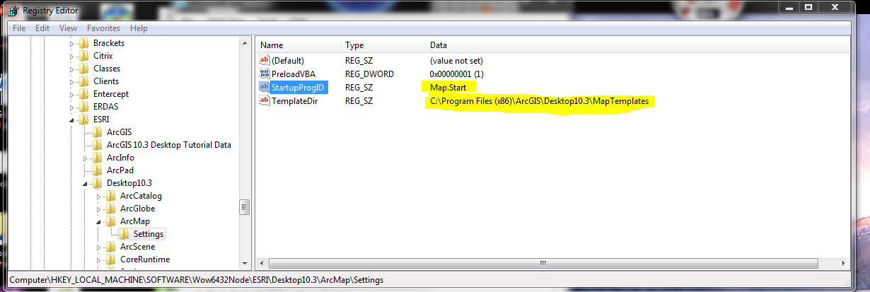

A search of the registry shows it
So that my give a clue on how to modify or control it, but again, a guess, either is it embedded in the normal.mxt, OR it just ignores is unless it finds the file in the C:\Program Files (x86)\ArcGIS\Desktop10.3\MapTemplates     folder.
I would try putting a new Map.Start file in that folder and see what happens.  (I would try it, but no time right now...and don't really know what would go into the file.)

...A ProgID is short for "Programmatic ID". It is usually an identifier for a COM/ActiveX top-level object that can be accessed using Visual Basic for Applications (VBA) or VBscript.
I did a search through my CLSIDs, and couldn't find a ProgID called "Map.Start".
Then I found this article:
ArcObjects 10 .NET SDK Help: the IStartupDialog Interface
...According to this article, the developer writes a .NET class that ArcMap will then look for and use upon startup. In Visual Studio, if you compile a project called "Map" and a class called "Start", and put it in the right place, ArcMap by default will look for and use that class upon startup. But by changing that registry entry you could call your project and class anything you want. That's why I didn't find a ProgID called "Map.Start" in my registry.
