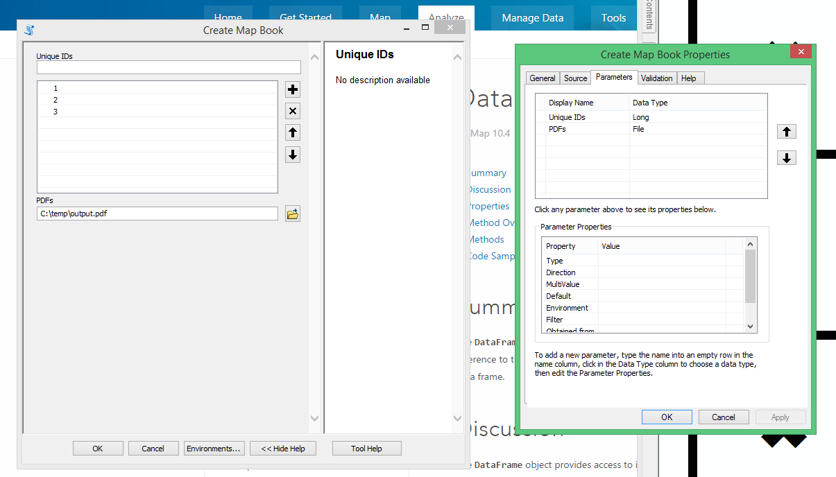

As a result of not needing a GUI in both scenarios we could leverage a custom geoprocessing tool with two parameters. The first parameter could be a GPLong Input that supports either single or multiple values. It would allow the users to input the unique id(s). The second parameter would be an output or derived GPFile. This would return the pdfs to the users.

Option B
This option would be very similar to the first option, but instead of manipulating each page manually you could leverage data driven pages to help with the look of the pages. Instead of selecting the features and zooming to them manually, you could use the user's unique ids to locate the pageName or pageNumber for the data driven pages. Once you have this information you could write out a single or multiple pages with a single call to the DataDrivenPages.exportToPdf function.
DataDrivenPages—Help | ArcGIS for Desktop
For example, let's say the user gave me the IDs 1, 2, and 3. With data driven pages I could just call exportToPdf(<PDF_LOCATION>, "RANGE", "1-3") and it would put all three pages in a single pdf. To do this with the first option would take several lines of code. DataDrivenPages would also allow me to easy establish the Extent with the properties of the DataDrivenPages in the Map Document. I could tell it that I always want scale to be a certain number or a number in the field, or I could use a grid to sure all of the extents are the same, or I could even have it adjust the extent by a percentage.
In it's simplest form, let's say that you named your data driven pages using the unique ids. If this were the case I could create the mapbooks with code as simple as the following.
import arcpy
mxd = arcpy.mapping.MapDocument(<PATH_TO_MAP_DOCUMENT>)
pageNames = arcpy.GetParameterAsText(0).split(';')
pageIDs = [mxd.dataDrivenPages.getPageIDFromName(pageName) for pageName in pageNames]
mxd.dataDrivenPages.exportToPDF(<PATH_TO_PDF>, "RANGE", ",".join([str(n) for n in pageNames]))
arcpy.SetParameterAsText(1, <PATH_TO_PDF>)‍‍‍‍‍‍‍
