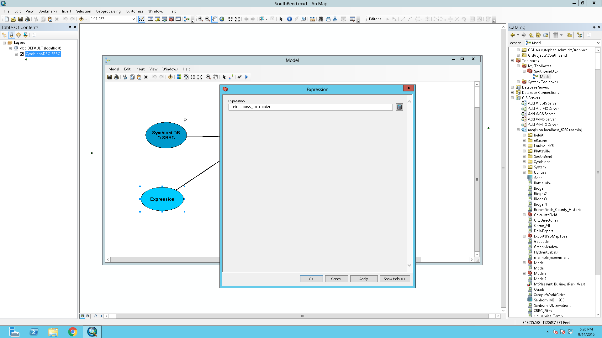

 Xander!  Thanks for the reply!  The Feature Service actually already has the field that I'd like to populate with the concatenation of three other fields.  What we're doing is building a URL in that field from a point ID (one field), and two auto populated URL pieces (fields two and three).  The final product is a functional URL. The point ID is specified by a user with the editor widget when they add a location to the map.  When the new location is created, the two parts to the URL are auto populated in their fields.  The next final step would be to run the geoprocessing widget to populate the final field with the combined three pieces.  When I run the model that I'm publishing as a Geoprocessing Service locally, it works great at generating the correct URL.  What's confusing me is that in the Geoprocessing Widget, the input and the output are the same feature service.  When I publish the model as a GP, it runs in the Geoprocessing Widget, but does not concatenate.  Below is a screen grab of the field calculator.  Thanks!!!
