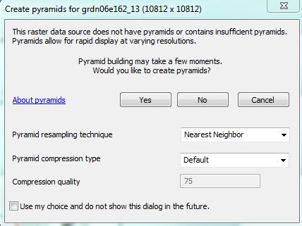

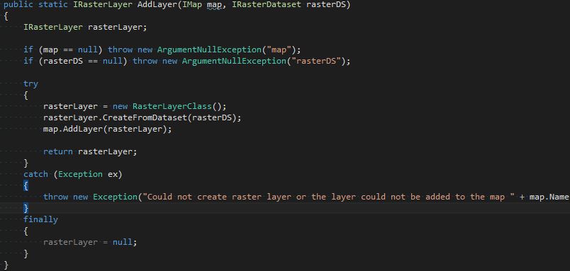

When adding raster data from the Table of Contents or the "Add Data..." option, the user is presented with a create pyramids dialog. I've noticed that when adding raster data from the code behind, this dialog is not thrown, even if the "use my choice and do not show this dialog in the future" box is unchecked. I'm wondering if there is a way to force this dialog?

I've continued some research on the internet but without luck. Wondering if this is even possible at all? Any suggestions are much appreciated.

No, but if you want to ensure that pyramids are built, then you can certainly program it to do so, at least using code snippets or toolbar emulations
