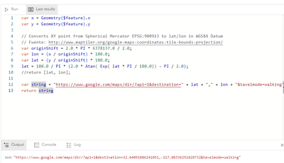

Thank you!  I had a Rest endpoint with only x,y in the attributes.
Your arcade worked perfectly to be able to use google directions
var x = Geometry($feature).x
var y = Geometry($feature).y
// Converts XY point from Spherical Mercator EPSG:900913 to lat/lon in WGS84 Datum
var originShift = 2.0 * PI * 6378137.0 / 2.0;
var lon = (x / originShift) * 180.0;
var lat = (y / originShift) * 180.0;
lat = 180.0 / PI * (2.0 * Atan( Exp( lat * PI / 180.0)) - PI / 2.0);
//return [lat, lon];
var string = "https://www.google.com/maps/dir/?api=1&destination=" + lat + "," + lon + "&tavelmode=walking"
return string
