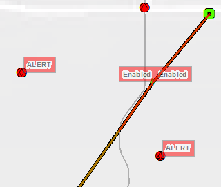

Dear Ted, i really thank you. In fact you right i totally forgot, so yes i need also second one because when i applied that script on my map screen showing like as below.
So is there any way to just show if "Enabled" field is 'False' and when "Status" field is 'Normal' retention for 'Enabled' label. I do not want to show that Enabled label on the map because everything is allright.

You can do it through code, like Ted mentions (return "" if you don't want a label), or set an SQL query to filter the features you want labelled.

Like Darren Wiens  mentioned filtering or modify my script above to return a blank string for the label (this happens when enabled is true -- actually it would happen if enabled is anything else except false)
vbscript
Else
   FindLabel = ""
Python
    else:
        return ""
