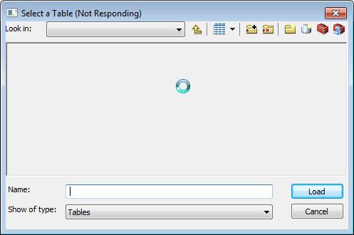

I have a standalone ArcGIS Application used for moving data around. It was written vb.NET using Windows XP and ArcGIS 10.0 and has recently been translated to C# on a Windows 7 machine using ArcGIS 10.1. (SP1).
Since being translated, the problem I am having is the IGxDialog window takes anything from 5 to 20 minutes to display it's contents and then when the Look in: location in the window is changed, such as choosing a directory, it takes another 10 minutes to refresh the display.
The code calling the browse Dialog window is:

The problem is caused by FME.
When IGxDialog.DoModalOpen is run, it calls lmutil.exe to obtain an FME license. The problem is that all two of our FME licenses are always in use.
The code doesn't have any FME references or Interoperability extension.
I uninstalled FME and the problem disappeared.
It would be interesting to know why this process happens.
John
JohnMcGlynn
If FME is installed with the 'Associate file types with FME' option ticked, the problem occurs.
To fix it uninstall FME and reinstall it with the Associate file types option set to 'No'.
