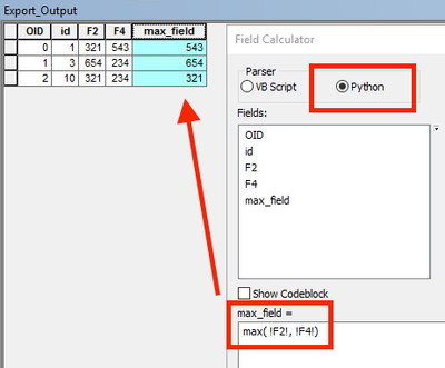

What doesn't work? Quick test seems successful:

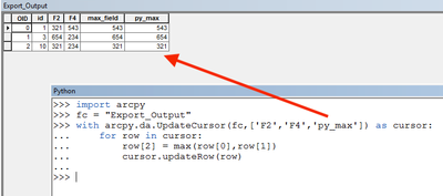

 Python cursor solution is successful, too:
