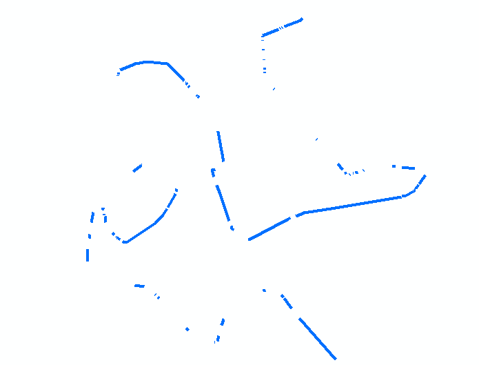

I noticed that the lines are not continuous:

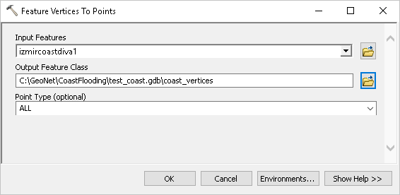

What I would probably do is convert the vertices to points:

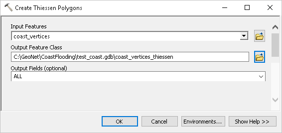

Create Thiessen polygons from the vertices:

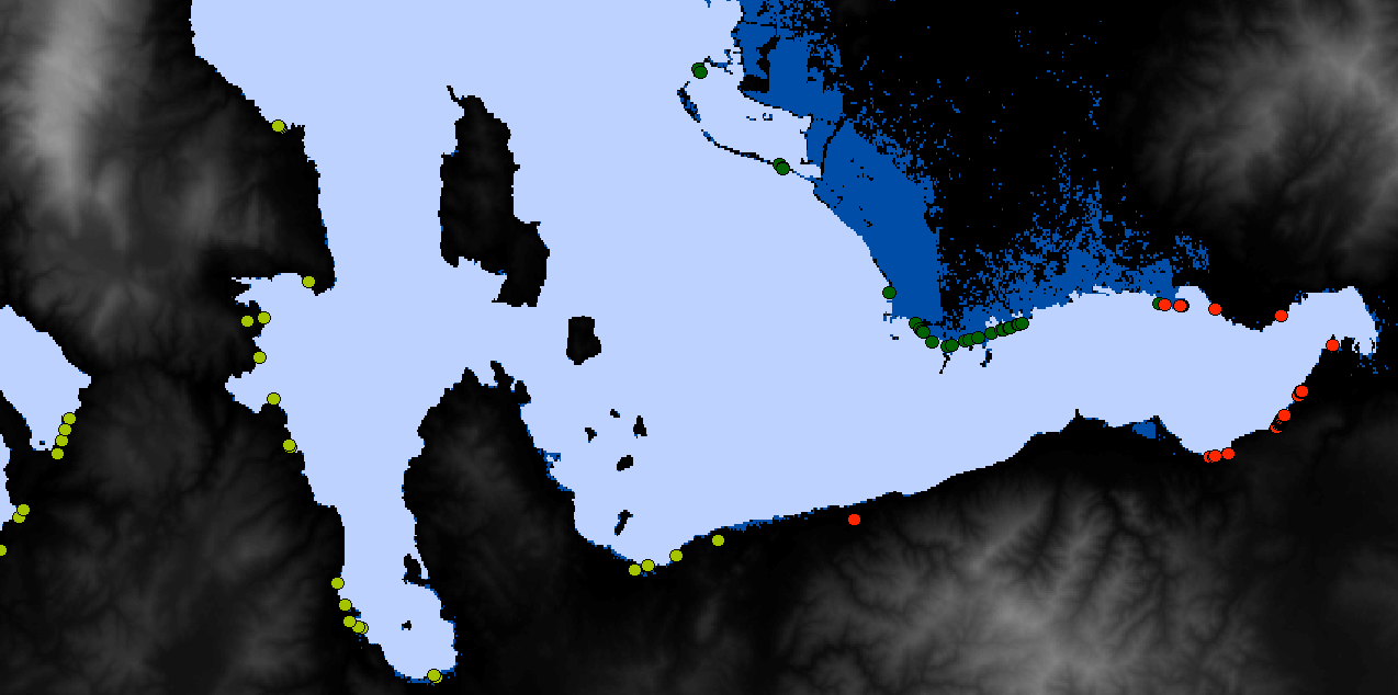

The result will be something like this ("flooded" area in blue):
As you may have noticed there are isolated pixels that have height values below the S1000 value, however those get classified as flooded too when they should be classified as flooded. To do this better you could have a look at this thread: https://community.esri.com/message/354091?commentID=354091#comment-354091
