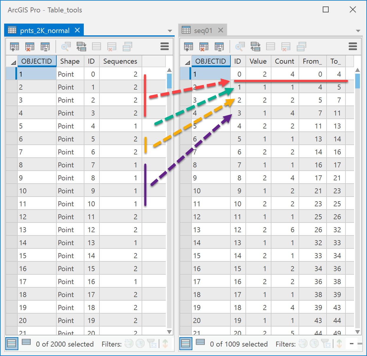

A blog is coming on sequences, patterns and replicants which will show how sequences and patterns of sequences and their representation and slicing (eg, start of sequence, sequence length and end of sequence) can all be obtained relatively simply and produce a summary table in ArcGIS PRO.
I will post back here hopefully within a day

If they are completely sequential... not just consisting of sequences... that is not fully clear from the question posed, it might be one of those expanding questions.
upcoming details soon
