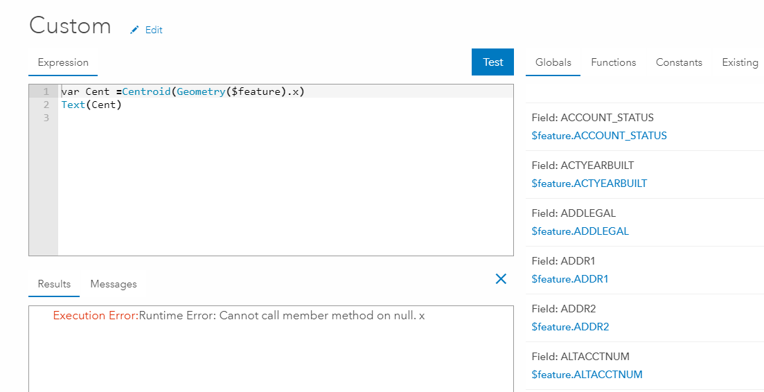

I need help with an arcade expression. I am trying to generate x,y pairs from a tax lot polygon feature service. In my "custom" field I have used the following expression:
var pnt= Centroid(Geometry($feature));
return Text(pnt);
RESULT...
{"x":-13649119.198784793,"y":5696311.278630899,"spatialReference":{"latestWkid":3857,"wkid":102100}}
but, I need the x and y to be returned in dec degrees, and my results appear to be on UTM northing/easting
I also tried to call a member method X and Y but I am getting the following error...
Thanks!
