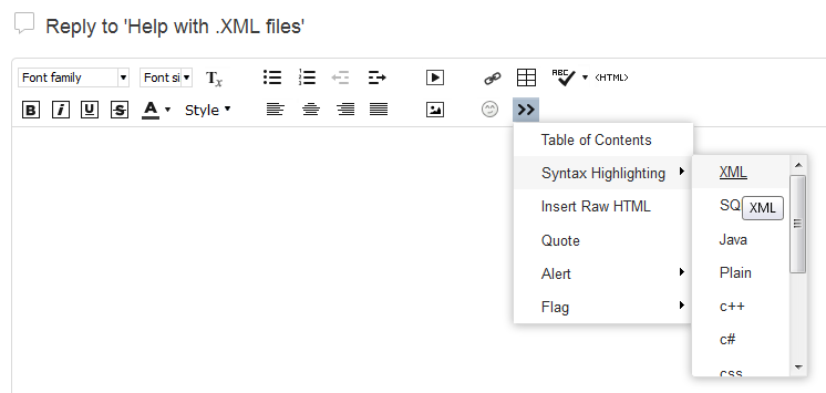

You can use the option of Advanced Editor. Then,
Think Location
RogerDunn2
Deactivated User
Jayanta I do not even see the Advanced Editor option when I reply to you.  The only options I have available are the Bold, Italicize, Underline, Strikethrough, Unordered List, Ordered List, Insert Image, Insert Video, Insert Link, Emoticons, Quote Previous Message, and Toggle Spell Checker.
JayantaPoddar
MVP Alum
Think Location
MattSnyder1
Deactivated User
It should be a link at the top right when you click reply that says "Use advanced editor".
