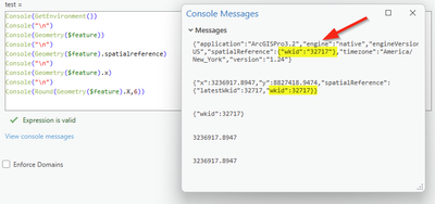

My apologies, it seems I'm thinking of another function, I copied your setup into a map, and created a feature class point with the same spatial reference, I then added a point somewhere in Brazil and attempted to use the functions, I was able to get it working without issue. I was curious if you would be able to use these functions and see if everything lines up, specifically the spatial reference of the map itself along with the point class.
Console(GetEnvironment())
Console("\n")
Console(Geometry($feature))
Console("\n")
Console(Geometry($feature).spatialreference)
Console("\n")
Console(Geometry($feature).x)
Console("\n")
Console(Round(Geometry($feature).X,6))
The arrow indicates the engine running, which is the correct spatial reference, and the highlights reveal the map and point spatial reference, please return with your results so we can figure this out further!
