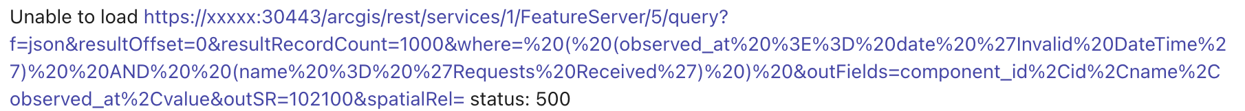

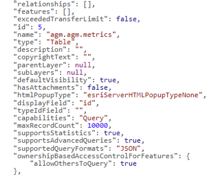

Update: I got an error return while exploring an unrelated issue.  It appears there is a recordCount parameter being passed that I did not set.
The default on the feature service is 10k records.
Any ideas how to override this in my expression?
Original Post
I'm running into some strange behavior with my data expression.  I'm trying to preprocess some data before it goes to my dashboard to reduce the data load.  However, I'm only now realizing that the for loop in my code (shown below) is terminating after 1000 records when there are more than 166k records in the input dataset.  I thought it might be a limit on the service, but it appears that the service is set to 10k.  Certainly l could foresee an issue hitting that limit, but in this case, the loop is terminating even before that point.  Does anyone see an issue in my code or has experienced this in their own work?
