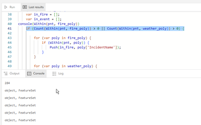

Your problem is on line 46 (as well as 48 and 54). Within returns a FeatureSet, which can't be directly evaluated in an if statement. You have to return some sort of boolean, such as
if (Count(Within(pnt, fire_poly)) > 0 || Count(Within(pnt, weather_poly) > 0)) {
jacob_ekn
Thank you! It's interesting because the function reference says that Within returns a boolean, but this got rid of that error. However, I'm now getting an "unknown error" so I guess my struggle continues for now.
KenBuja
MVP Esteemed Contributor
I was looking at the FeatureSet Within instead of the Feature Within. Still, when I ran a test on the Feature Within, it returns a FeatureSet.
I misplaced a parenthesis in the second Count. Try this instead.
if (Count(Within(pnt, fire_poly)) > 0 || Count(Within(pnt, weather_poly)) > 0) {

You can use Console to test out where the script is breaking. If I have a problem with the script, I sprinkle them throughout to find the problem line.
As it turns out, I was incorrect for lines 48 and 54. I was mixing up the Withins. The one on line 46 is a FeatureSet Within and doesn't return a Boolean, while the other two are Geometry Withins which do return a Boolean.

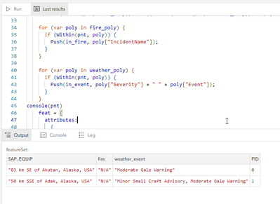

I was testing on some public data and got it to work
var portal = Portal("https://www.arcgis.com");
var fire_poly = FeatureSetByPortalItem(
  portal,
  "d957997ccee7408287a963600a77f61f",
  1,
  ["IncidentName"],
  true
var weather_poly = FeatureSetByPortalItem(
  portal,
  "a6134ae01aad44c499d12feec782b386",
  6,
  ["Event", "Severity"],
  true
var pt_fs = Top(FeatureSetByPortalItem(
  portal,
  "9e2f2b544c954fda9cd13b7f3e6eebce",
  0,
  true
), 80);
var features = [];
var feat;
for (var pnt in pt_fs) {
  var in_fire = [];
  var in_event = [];
    for (var poly in fire_poly) {
      if (Within(pnt, poly)) {
        Push(in_fire, poly["IncidentName"]);
    for (var poly in weather_poly) {
        Push(in_event, poly["Severity"] + " " + poly["Event"]);
console(pnt)
    feat = {
      attributes:
          SAP_EQUIP: pnt["place"],
          fire: IIf(IsEmpty(First(in_fire)), "N/A", Concatenate(in_fire, ", ")),
          weather_event:
            IIf(IsEmpty(First(in_event)), "N/A", Concatenate(in_event, ", "))
    Push(features, feat);
var out_dict = {
  fields: [
    { name: "SAP_EQUIP", alias: "SAP Equipment ID", type: "esriFieldTypeString" },
    { name: "fire", alias: "Name of Fire", type: "esriFieldTypeString" },
      alias: "Weather Event",
  geometryType: "",
  features: features
return FeatureSet(out_dict);
