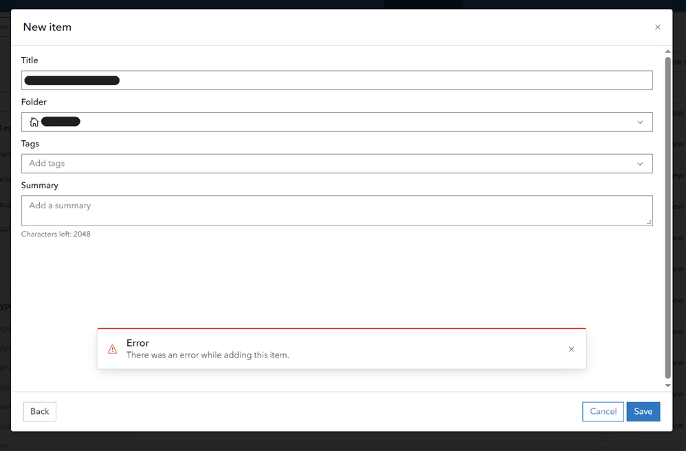

Hello all!
I am having an issue adding an Experience Builder Widget to our new ArcGIS Enterprise 11.4 environment. This widget was uploaded and functional in our old environment on 11.3, so I have been troubleshooting why it can't be added this time around. NOTE: The new system has had issues where there isn't a 1:1 match on things. For example, a previous issue was resolved with a firewall adjustment, so it is possible that a system change could fix the issue.
My initial thoughts are that there is some sort of connectivity issue with Portal to Server due to the 500 error on a POST request, but I am not too sure what the issue is or how to pinpoint it to try and fix it.
Here is my workflow:
  1. Create widget locally in experience builder 1.14
  2. Use command terminal for npm run build:prod
  3. Add the prod-dist files to S3 bucket for hosting
  4. In ArcGIS Enterprise Portal: New Item > Application > Experience Builder widget
  5. Add the URL path to manifest.json
Brief system background:
  • ArcGIS Enterprise 11.4
  • Windows OS
  • AWS infrastructure
Error messages:
Network tab:
    "error": {
        "code": 500,
        "message": "Exception. Unable to add or update item: f9814f6d4db946bfb1a3bacfb52be8b2",
        "details": [
ArcGIS Enterprise:
Error from ArcGIS EnterpriseError from ArcGIS Enterprise
Console:
Console error messageConsole error message
