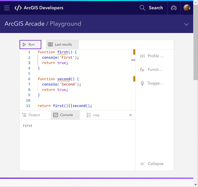

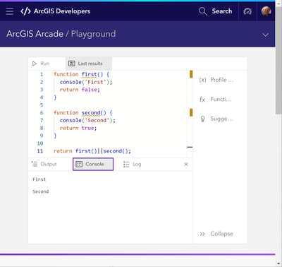

It turns out my code was incorrect, since the function calls need parenthesis behind them. When I fixed it, it does short-circuit.
If the first function is false, then the second function runs
If the first function is true, the second function doesn't run
