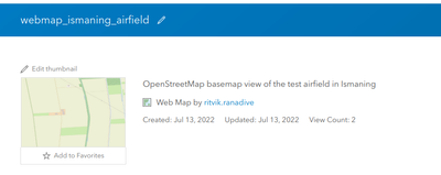

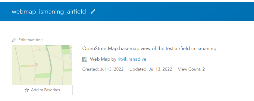

I have created my own web map with the Map Viewer application.
A screenshot from my account:

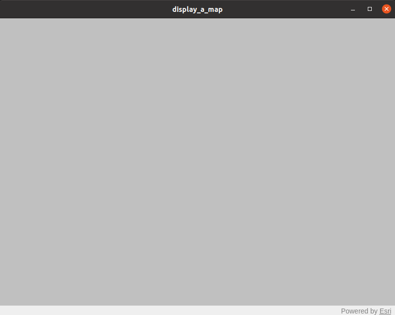

I am trying to display this web map using the tutorial.
The only thing I changed in the code of the tutorial was the item_id in Step 3 of the section - Initialize the map using a web map.
When I build and run the code, the window in which the map is displayed is empty. This can be seen in the screenshot below:

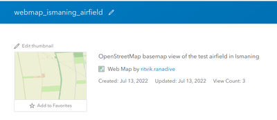

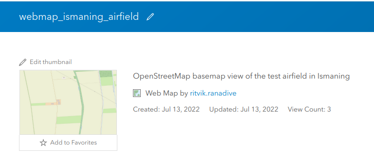

However, immediately after this if I check my account again, the View Count for this map has increased.
