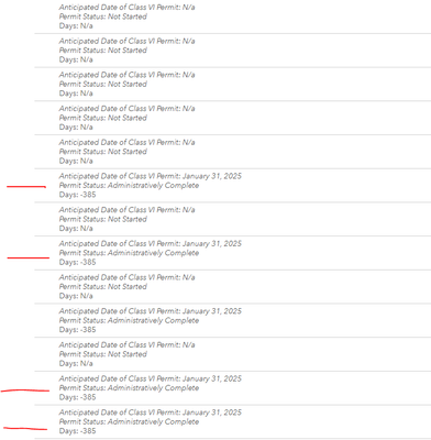

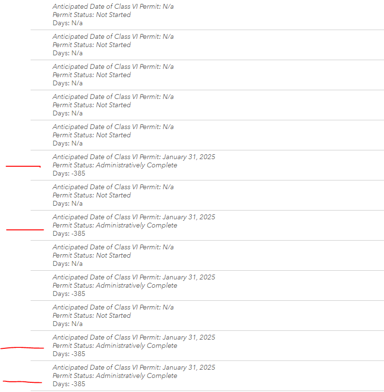

This is what the code currently returns, duplicates have a red mark next to them:
The desired result is that only one of the duplicate rows is returned.

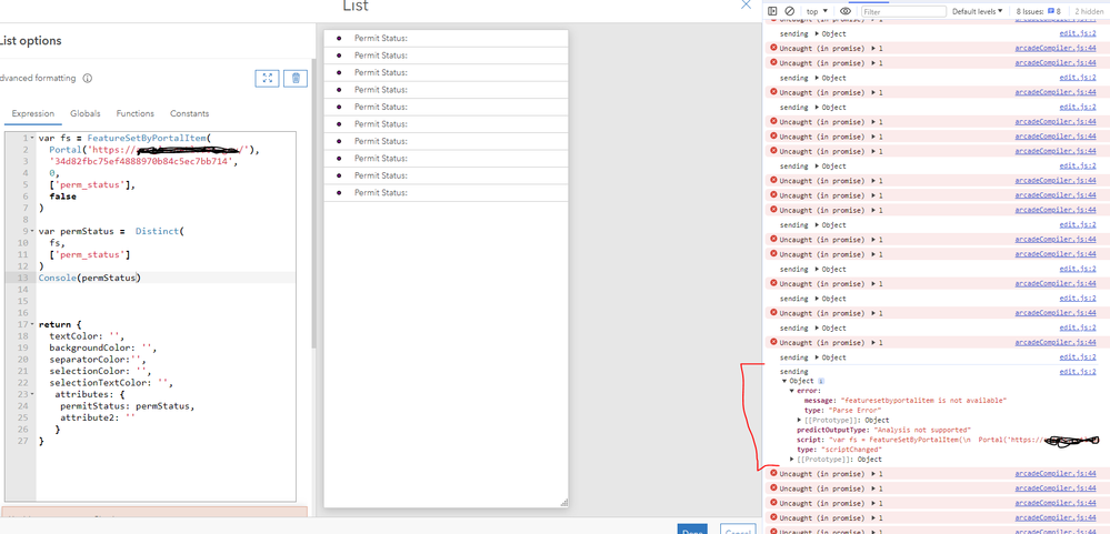

When attempting to return Distinct values, I am getting this Console error. We only have Enterprise 10.9.1 - do you think that may be a reason the analysis isn't supported?

What you're seeing is a result of  the particular Profile you're using.
https://developers.arcgis.com/arcade/profiles/
In the Advanced Formatting, you cannot use FeatureSet functions. To use a Data Expression, you've actually got to go all the way back to where you choose a data layer for the widget, then say "New Data Expression" there.
