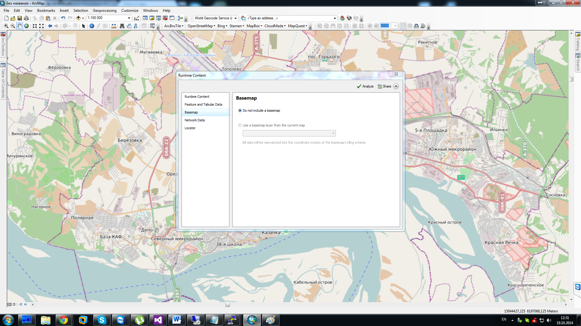

Is it possible to create runtime package using own local custom OpenStreetMap server (with rotated map) as basemap ?

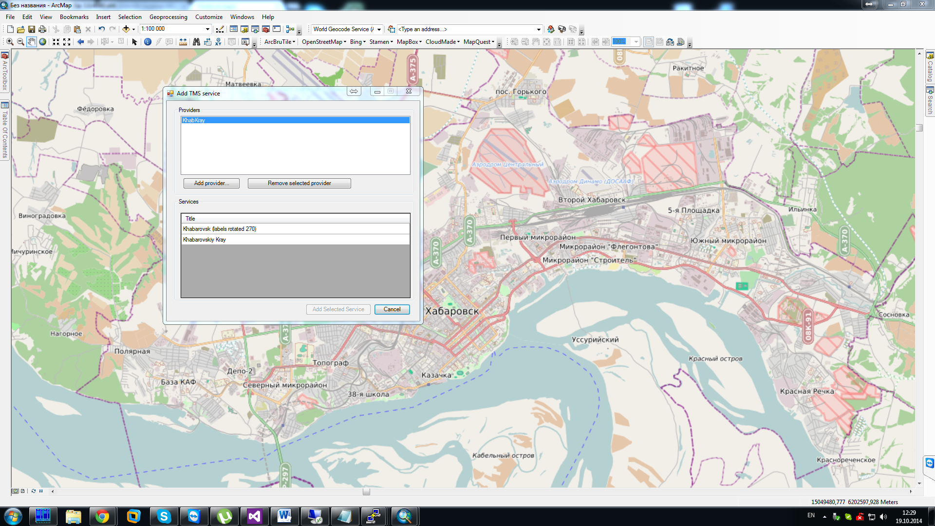

ArcMap allow adding only 9 online services as basemaps (Imagery, Imagery with labels, ...., Oceans, OpenStreetMap). I downloaded and installed ArcBruTile, added my tile server (TMS service), but when I'm trying to "File -> Share As -> Runtime content" I got grayed "Use basemap ..." checkbox...
Is there any way to add tms service as basemap ?
