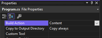

Have you tried right-clicking on the included ml64i4.dll file in Visual Studio and set Build Action to Content and Copy to Output Directory to Copy always (or Copy if newer)?
Best Regards,
/Markus
MattiasWesterberg
Yes. But it is still not working.
