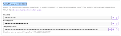

one of the parameters in the url request is the following:
When I try to create the OAuth 2.0 Credentials I only get a temporary token id
I am not sure if I can make the token permanent and store it into the web app so that every user has the same.
