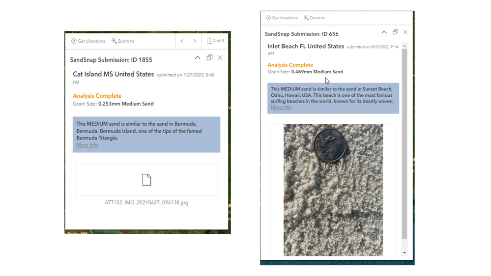

Did you find a resolution?  I have a ExB application that reads a map built from the the "new" map viewer.  These screenshots are from the same layer and and having the same problem.  Records I appended yesterday (image on left) are only showing as links, not the actual image (like an older record on the right). Layer properties are set to "Gallery".sample.pngsample.png.

I am having this same issue, but only with image attachments that are added to a related table through ArcGIS Pro. When added through the new map viewer, the images appear as expected in gallery mode.

I am having a similar issue. Because I can't specify which image questions to include in a particular widget, I've created copies of the data that only include images from each question. I've updated these databases using the append tool in ArcGIS Pro and know that the images are there (viewable in AGOL and the Survey123 web app), but they do not appear in my Experience Builder app.
Perhaps related is that the attachments included in the original creation of the database open as new tabs whereas the appended attachments download (if clicking the attachment link from AGOL).
